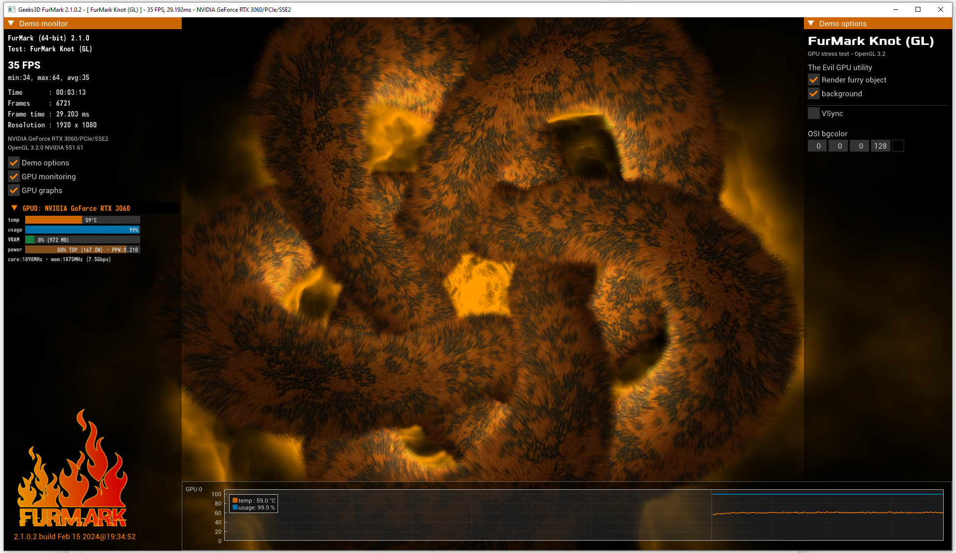

To be sure your video card is ok you can download a little tool called FurMark. Like KeyShot that will utilize your GPU to the max and if it crashes or hangs your system you know it’s not KeyShots issue but either hardware or driver related. Don’t run it if you’ve files open you want to save since it could potentially hang your windows so you need to restart your PC.
If FurMark crashes (that will happen quite early most of the time, like within a minute) it could be several things but it’s not related to KeyShot. Things that can be the problem are a defect of the GPU or for example a defect of the PSU which supplies not the power it needs constantly.
If FurMark runs nice I would reinstall the NVidia drivers. You can install the same but there’s also a more recent version if you want. If you install them I always pick custom install and without the GeForce Experience stuff. Also important is that you select the box ‘Clean Installation’ that will delete old files/cache first and install new drivers after the clean up. The screen will be blank for a minute or two but that’s normal.

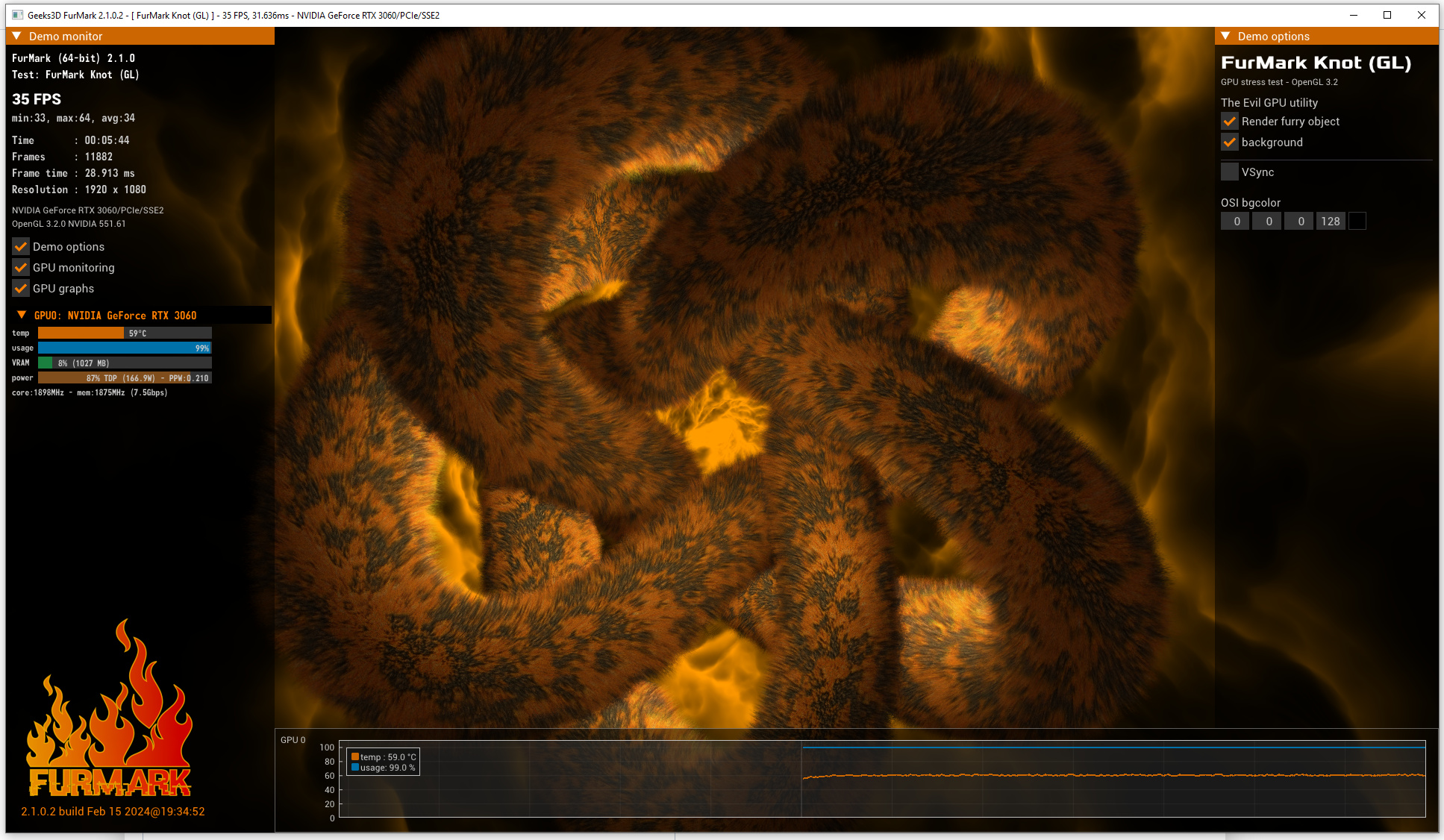

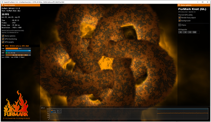

Run the test “Furmark” for about 3 to 4 min a few times on different settings and it did not crash.
What can I do nnext ?

If the card gets 3-4 minutes in FurMark the GPU/PSU you can consider ok.
